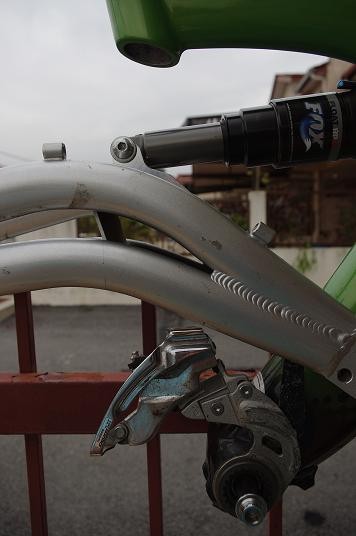

Does anyone have a picture of the 190mm shock mount installed?
billetmetalcraft.com
30 Sep 2010 06:03 AM
I'll take a picture... of one and post it here... hang tight
Posts:23
30 Sep 2010 01:56 PM
ive got a pic of the one i had to mod a bit to fit this shock.
shock mount
brettmeyer
03 Oct 2010 12:53 AM
04 Oct 2010 07:23 AM
http://i3.photobucket.com/albums/y84/aaronpang/Terrashark/TerrashakExtendedShockMount2.jpg
http://i3.photobucket.com/albums/y84/aaronpang/Terrashark/TerrashakExtendedShockMount1.jpg

09 Jan 2011 04:41 AM
The quotation is RM100, per unit.
I'll need a show of hands how many pieces to order if more than a handful order we can get a better price
I'll be placing an order on Monday and the shocks will be ready in a weeks time.
Edit:- Picture of the mount installed on a T-Bolt hope it helps!

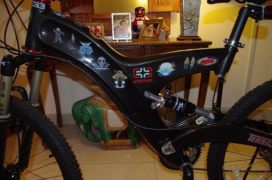

Regarding the material used its the same stuff as the original mount.
The FD bracket it will fit fine I own both a Terrashark and T-Bolt frame and I've posted the pictures on this forum with the shock mount in use.
Neither frame has any clearance issue with the FD. If you install the extended mount and need more clearance just rotate the FD bracket backwards a little bit.
